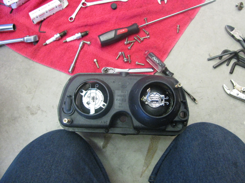

First, a little picture to help illustrate why an HID kit doesn't work. Look at the two bulbs here. That big long HID thing does not put it's light in the reflector where designed so the light is not put where the designers intended.

First, here is a shot of my headlight bucket with the proper bulbs in place.

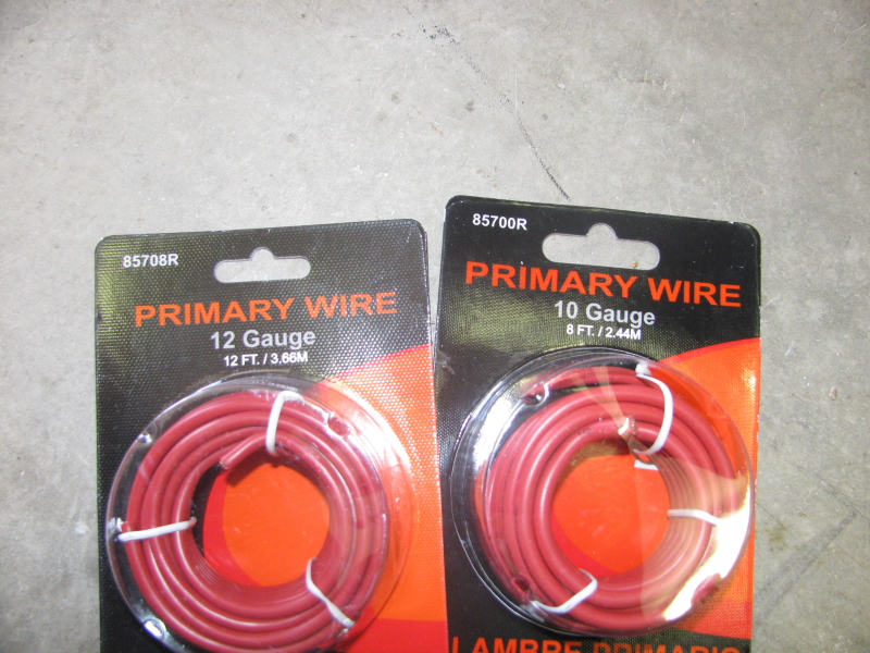

To add bigger wires, you also need to add relays. You can get weather sealed 30 amp relays at Radio Shack, or I got these at Auto Zone. Don't forget a fuse holder at the battery too. Don't want to burn the bike down just because we want better headlights.
I believe in overkill here, so I went with 10 gauge wire where the run was common to both high and low beams and 12 gauge for the rest. Another thing to remember is that is you are increasing the size of the hot, just as much goes down the ground so upgrade those too (and I did run those all the way back to the battery too.

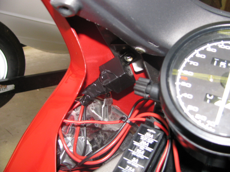

Here is one of the relays ready to be secured in the out of the way place I found for them.
On a motorcycle this is about the hardest part, finding a place to add the relays. Running the wires to the battery is the next. Make sure you don't pinch them or put the near any moving parts.
And on my ST this is where I found to hide the relays, on the bolt that secures the mirror on each side up under the nose fairing. This will keep them out of the weather (a good idea even though these are weatherproof relays)
