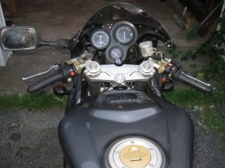

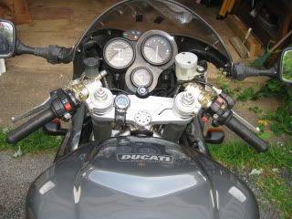

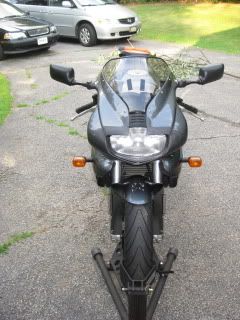

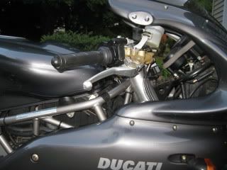

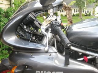

Basically, here's what I did:
- Loosen the screws for the actual bar's. The inner screw has to come all the way out, because there's actually a notch in the bars, a key slot if you will.
- Loosen the actual clamps.
- Remove the clamps and the spacers ( Leaving the spacers caused a clearance issue ).
- Flip the clamps and put them upside down and on the opposite side
- Slide the bars back in, but not all the way. In order for the inner screw ( see key slot above ) to go all the way through, you have to actually leave the bar just slightly out. This actually gives the effect of longer bars too
Adjust and tighten
I haven't been on a ride, and there is still a slight interference at full lock but that should only come in to play in duc walk maneuvers, not actual riding. The angle of the bar is significantly improved.It seems a little higher, but its tough to tell.
I'll give a ride report next week. It lacks the adjustability of something like the SpeedyMoto's but its an hours labor at no cost, so I thought it was worth a shot. If it doesn't work out, I''ll just go for the Speedymoto's or Woodcraft's was suggested to me.
Here's some before and after pics ( I put on my CRG mirror too ):
Before:

And After:
