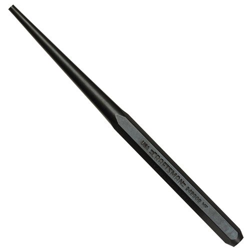

An alignment tool/punch works very well in this case. It's good for a lot of installations too. Mostly automotive.

Quote from: JonS on April 29, 2012, 04:03:00 AM
How. precisely, does that work??

Think of it as an axle on the other side to help hold the wheel up and get it aligned. As you tap the actual axle through, you'll be pushing out the alignment tool.

the combination of using your feet to raise the wheel and the punch to help roughly align the swingarm/wheel works great --
every now and again, when installing a wheel/tire combo that heavier than my much abuse ankles want to lift, I'll grab my long crowbar and a short piece of 2 by . . . . . use the wood as a fulcrum, the crowbar as the lever, and move the world!
